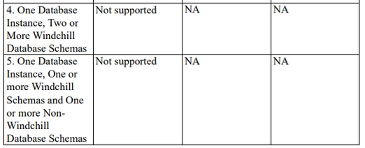

Hi @apriori-it
Have you ever read instalation guide?
The PSI do not support to install your second Windchill DB to the existing one.
I can imagine that you install it to an another instance and move the new database to existing one after Windchill is installed. but I can not recommand it.
