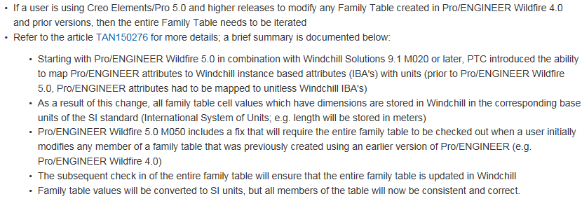

Nov 5, 2015 12:39 AM UTC
If the family table was already re-verified in Creo 2, then it should not be happening again simply by going to Creo 3.
Relevant Section:
