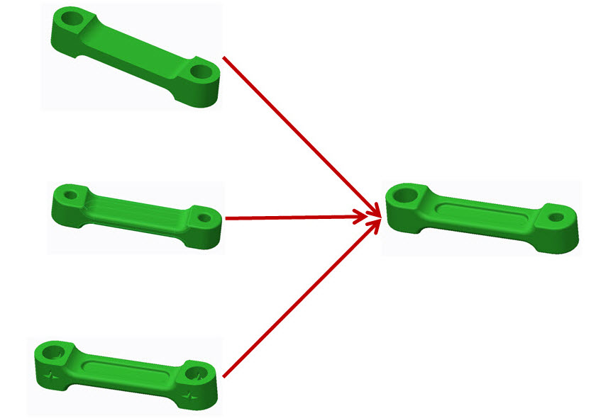

What is this feature?  It is the "Integrate" feature.  It allows you to quickly identify the necessary features you need from multiple designs and bring into a single, source model.
There are several use cases where you may need to take the same models that have different features, and bring back into one source design.

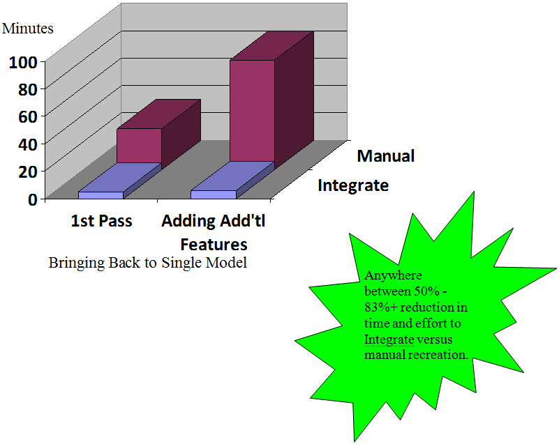

Is there really that much of a benefit in being able to streamline this process?  Let’s take a look at an example and assume that I have two iterations that took around 20 minutes each to develop.  In order to manually bring the features that I want back into the source model would require at least 30 minutes to identify the differences and to re-create the features that I want.
Using the “Integrate” functionality, I can achieve the same results in around 5 minutes.
Also consider the exponential impact that this function may bring.  As it takes anywhere between 1 – 50+ minutes to create additional features and then double that to re-create the same features, you are looking at most a minute to identify and bring that same feature back into the common model.
