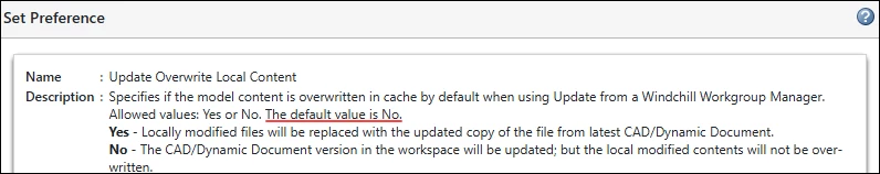

  • Windchill has a preference/setting called “Update Overwrite Local Content” (located in the Workgroup Manager Client section) to control the Update command default to Reuse or Download files when the user has local workspace modifications. In my opinion, No/Reuse is a terrible default value, and admins should lock this setting to Yes/Download.
    • Yes = Download as default:
      • Download will make the Update command use the latest file(s) from Commonspace. If a user Updates a locally modified file, any local changes will be gone. We tell our users to check out before making changes. If you had changes you wanted, then you should’ve checked the object(s) out so someone else couldn’t make changes.
      • This makes it harder to check in old versions (which is a good thing!). Reuse can still be set manually in the Update menu and is best left to power users / admins who wish to restore an old version of a file.
    • No = Reuse as default
      • Reuse creates different Update behavior based on the question “Do local workspace file(s) contain modifications?”:
        • No workspace modifications: - Commonspace file(s) and metadata will be downloaded.
        • Workspace modifications: - Only Commonspace metadata will be updated, and the local modifications will be kept. This will enable the old file(s) to be easily and accidentally checked in as users think they updated to the Commonspace file(s). Most users do not understand this and easily/accidentally checking in old versions is not something a PDM system should want.
          • Note: Sometimes native CAD will modify itself upon open/regen if there’s external references, etc. which can modify the files in the workspace, making this situation worse. Smart Locking can help reduce this but reduces effectiveness of external references.
    • Additional info/preferences can be found in this article: https://www.ptc.com/en/support/article/CS135234
