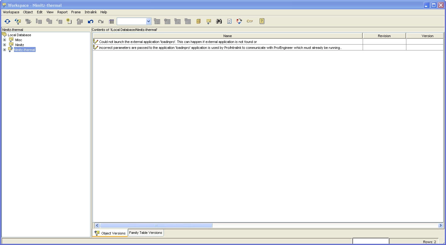

We are having an environment or path problem with IL3.4 and WinXP64 bit.
everything runs fine, however when pro/e is running and the user goes back
into IL3.4 and tries to show the workspace he gets this on his workspace
screen. See JPG.
He can view commonspace no problems. Any Ideas out there.
Ron

Make sure that your paths are correct in both apps. Ilink has a path to the Pro/E loadpoint and Pro/E has a path to the ilink loadpoint. You can check/modify them by running the ptcsetup.bat in the respective bin directories. Hope this helps.
