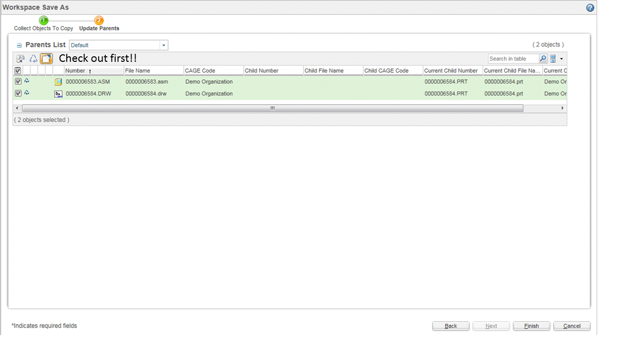

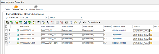

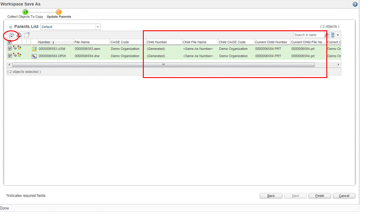

Hello.
In Workspace Save As, you can use the 2nd step on the wizard called "Update Parents" to modify the assembly (and other parents in the workspace like the drawing) to use the new copy.
Things to keep in mind when switching from Pro/INTRALINK 3.x to Windchill:
- Modifications can only be made on objects that are checked out, so if the assembly is not already checked out, you will need to use the check out icon before you can set it to use the new copy.
I hope this helps.

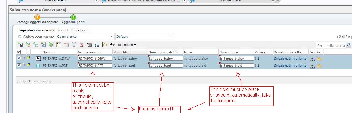

mamobono10-MarbleAuthor
Jan 9, 2017 1:53 PM UTC
Jennifer thanks for the reply
I have another question
You can only put the new file name and have automatically:
the new number field and the new name field empty, or automatically, with the same name of the new file (see image )
There is a setting for this?
Now I have to enter the new name 6 times

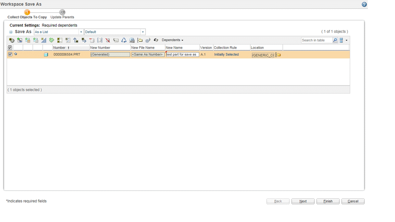

Hello.
Yes.  You can set up an Object Initialization Rule for CAD Documents to generate the Number and Name from File Name.
(see help center chapter Specialized Administration > Tailoring Business Objects > Understanding Object Initialization Rules)
You can add rules to set CAD Doc's number=CADName and name=CADName.
The result will be in New CAD Document, Rename, Save As and when you upload and check in, all three values will be the same by default:
Here is an example the .xml file used to create this OIR:
