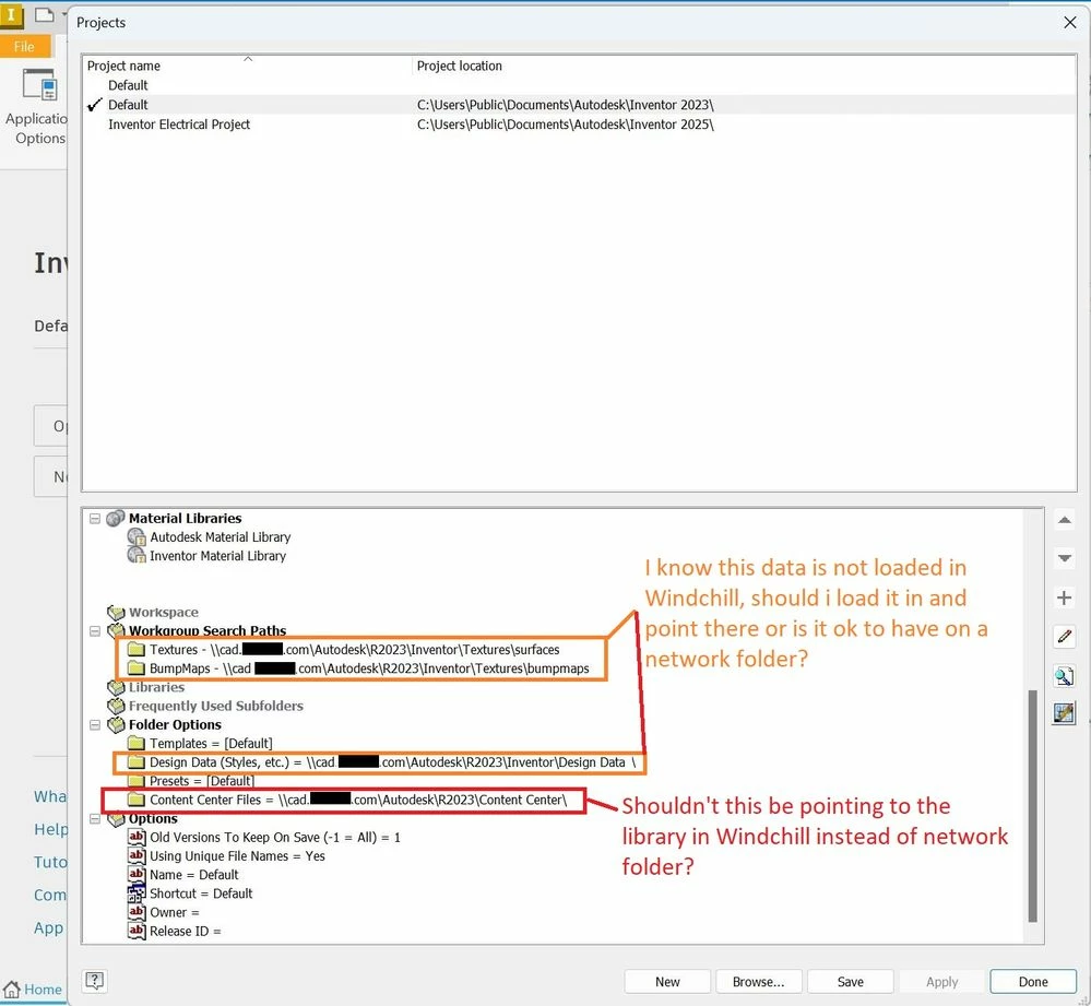

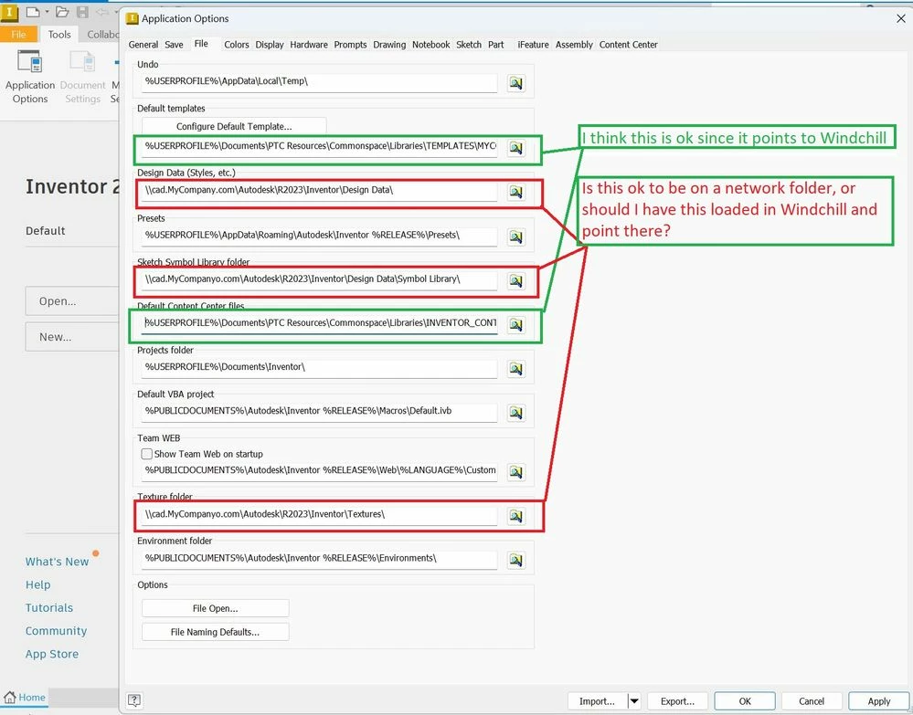

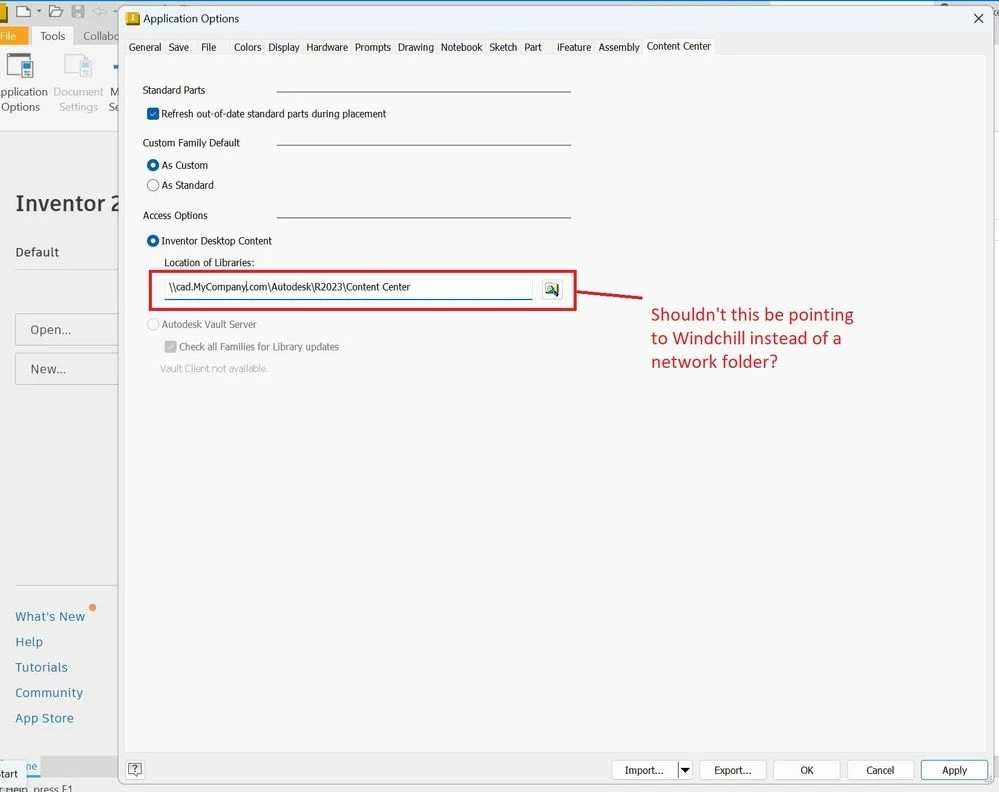

My company have integrated windchill and inventor some years ago, before my arrival
Now I'm reviewing the configuration and I think we have some issues, mainly on the Inventor's client settings side.
For example, regarding the inventor "content center", we've correctly created a library in Windchill and imported all the content center parts, etc, but on Inventor's side, under settings, I'm not convinced that the paths are configured properly.
I'm attaching some screenshots with comments of the current settings, for the tab "Files" and "Content Center"
and also another screenshot of the Default Project.
I'd like to get some feedback by someone who is successfully using Inventor with Windchill,
If you could share what are your settings/default project I would really appreciate it,
Also if  you have other advices, i'd be happy to listen
thanks

All the file paths in your screenshots of the Inventor app options should be windows network or local file paths.
There’s a setting for the content center library folder in Windchill preferences.
https://support.ptc.com/help/windchill/r13.1.1.0/en/index.html#page/Windchill_Help_Center/WWGMforAutodeskInventor/WWGMInvAdvTechInventoriPartFactContentCenter.html%23
