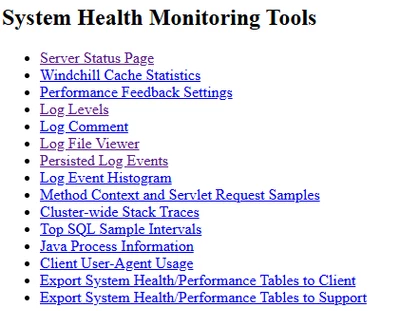

My Question was generic, like in windchill system multiple logs file are getting generated so i wanted to ask is there is any tool defined so that tool can help to investigate logs quickly instead of reading each log file line by line. if there is any tool i wanted to know about that.
avillanueva
23-Emerald II
Mar 6, 2025 12:18 PM UTC
You'll want to look into IT or security related tools. These would be used by a system, security or network administrator to ingest log files from various sources and analyze them. Inside of Windchill you have the Server Status popup which has some tools to view and search log files online. I am assuming your are looking for something beyond this correct? Is there a specific thing you are looking to do or look for?
