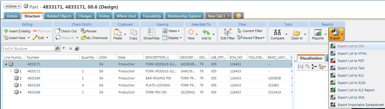

Mar 2, 2016 9:15 PM UTC
From the structure page, when I select export, I get all four items structured under it in the exported file.
Windchill 10.2
