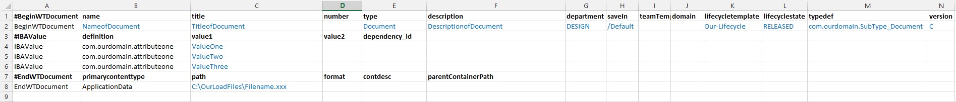

You can definitely create a single load file which includes custom soft type attributes loaded as IBAs. (10.1 M040 & 10.2 M010 verified)
Example of a single Document record (csv file) with x3 custom attributes.....
The CSV2XML output XML would look like.....

If you aren't letting Windchill assigned the Document Number it's also possible to include load elements for Distribution Targets and Described By links in the same file. Note; normally we let WC assigned the Doc. Nbrs. so it's a seperate step to pull WC data to formulate these supplemental loads.

Thank You Ben Thompson. Actually I was doing some lengthy process for IBA.Your description is really very helpful.
