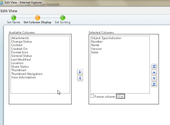

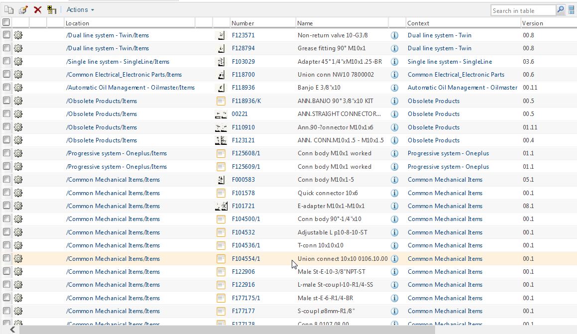

Is it not possible to visualize field "Descrizione" inside Search page?
Greenshot_2015-09-03_10-46-33.jpgIs it not possible to visualize field "Descrizione" inside Search page?Greenshot_2015-09-03_10-43-15.jpg

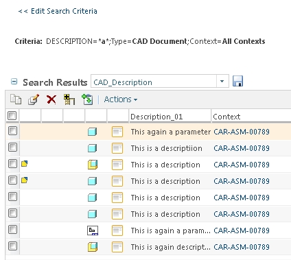

Hi Shirish,
Thanks for the steps. I had a similar requirement.
I had a user who wanted to see description field designated parameter from Creo (Default description attribute can be filled only when you create EPM Document from workspace.) So we ended up creating a new Global attribute and designated it in Creo.
To bring this to search results, all what we did was creation of a new view specific to CAD documents. But again this was type specific, in the criteria if you select just CAD document as type, then it would use the custom view with the description attribute. If you select multiple object types, then the only general system attributes would appear.
