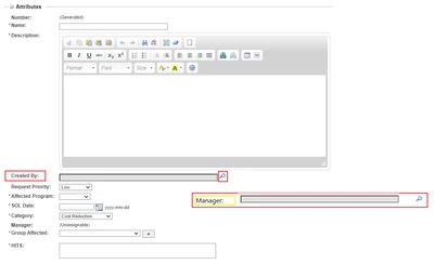

Is it possible to add another attribute to look up a user, while creating a Change Request
Can we add another user lookup kind of attribute to this create change request page? similar to 'Created By' user lookup field?
Sep 14, 2023 10:31 AM UTC
Yes you can add a custom attribute & then implement a custom picker for picking up a wtuser. check CS335501
Oct 3, 2023 1:55 PM UTC
Can I get a more detailed description on how to create a user picker, what are the files that need to be changed, and if a WC Restart if required? I tried to follow the document and it's not working for me.

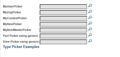

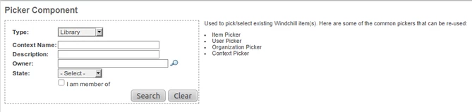

Hi @RG_10753677
Check windchill documentation in your instance
httpaddress/Windchill/app/#netmarkets/jsp/componentCatalog/pickerComponent.jsp
Catalog contains many basic information for customization
httpaddress/Windchill/app/#ptc1/componentCatalog/componentCatalog?oid=OR%3Awt.org.WTUser%3A207&u8=1
