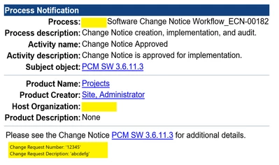

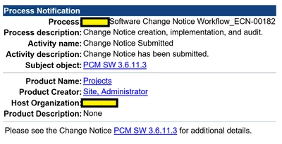

Is it possible to add Change Request Number in the email notification?
Objective:  Change Request/Change Notice Number and description attributes in the Workflow Notification Email.
In the workflow template, Is there a way to add Change Request Description/Number as variables ?
Currently, the email looks like this
But, I'm looking for something like this with Change Request/Notice attributes in the bottom.

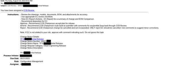

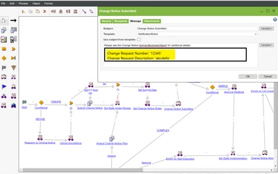

Documentation is above. You need to customize the codebase/templates/General*.html files like below. This is mine to show the PBO name and number. The pboNumber is a workflow variable so you can call those out too. This modifies the email subject as it appears.

Next I modified the task Instructions to include data which would appear in the subject of the email:
The final result is like this:

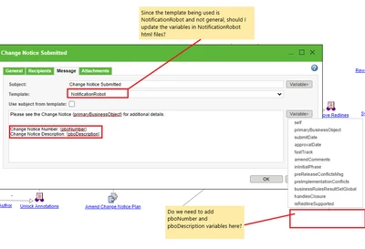

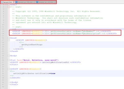

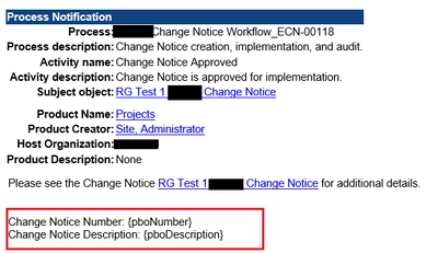

Aug 16, 2023 6:33 PM UTC
I've updated General, General_en_GN, General_en_US html files.
But since the template in my workflow is NotificationRobot template, I am wondering if I should change the NotificationRobot html files instead of General.* html files.

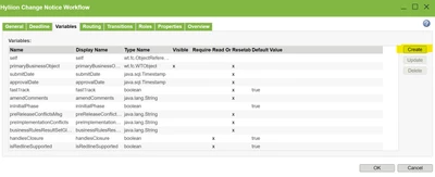

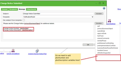

Next, Does the variable need to show up in the dropdown for it to work?
This is the output so far. My email notification has {pboNumber} and {pboDescription} variable names instead of their values. Please let me know if I'm missing something.
HelesicPetr
Aug 17, 2023 6:22 AM UTC
Hi @RG_10753677
Sure you need to update the correct html template. So if you use notification robot you need to update that one.
If the variables do not exist then it will not be shown in the email.
You need to create the variables in the workflow and fill up with correct values by code.
PetrH
