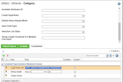

Is it possible to change the legal value list values of an attribute on Change Request?
Sep 11, 2023 4:30 PM UTC
Refer this article,
https://www.ptc.com/en/support/article/CS56565?source=search
OOTB constraints cannot be edited. But you can always add a new constraint based on your requirement.
And better use enumerated value List over legal value.
