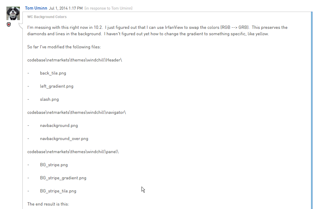

18-Opal
Apr 13, 2016 6:24 PM UTC
For those modifications you might want to visit this discussion: WC Background Colors
Look for this response from Tom:
