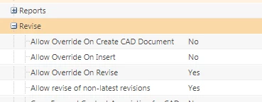

November 13, 2017
Potentially, it depends on your REVISE preference settings
November 16, 2017
The preference Allow Override On Create CAD Document set to “Yes” should allow you to specify the same revision as the Part when initially creating the CAD document for the drawing
