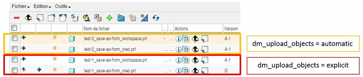

When I "save as" a CADdocument from creo (file/save as), the result in my local workspace is a new component not loaded.
Whereas when I "save as" a CADdocument form local workspace (action/save as), the result is a new component loaded.
See the print screen below the differents results :
Is it possible to NOT load the CADdocument when I use the SAVE AS command of the workspace ?

Your config.pro option "dm_upload_objects" needs to be set to automatic for this to be automatically uploaded. The default value is explicit which does not upload on a save.
Oct 3, 2018 8:46 AM UTC
thanks for the reply but It's not exactly that i want to do.
From the workspace, I don't want to automatically load the document after the "save as"
Please see the printscreen that show the expected result.
As a reminder, in attachments i put the example of how the parameter dm_upload_objects works

I see I misread your question. I originally thought you wanted both to be uploaded. I do not know how to control the Workspace save as behavior. A quick search for "upload" in the Preference Management did not lead to any preferences that deal with workspace save as behavior either.
