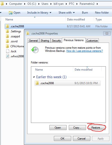

Sep 3, 2015 12:59 PM UTC
One more option that I've used for recovering Data out of a user's local cache folder is the "Restore" function in Windows Explore.  This is last resort after 1 and 2 have been used above.
