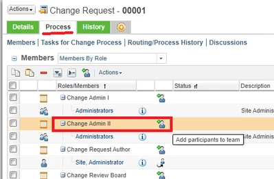

Is there a way to assign a new change admin 2 to a Change Request, when the Change Request is already running?
HelesicPetr
August 29, 2023
Hi @NB_10021874
Sure you can add them to the ChageRequest role in a Process Tab
