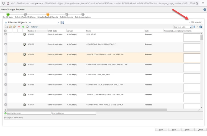

Is there a way to edit the maximum number of allowable WTParts in a Change Request?
I have some users who are attempting to modify many parts in a Change Notice, and have found that the upper limit of WTParts in the Notice is set to 40.
Is this a limitation of Windchill, or was it something that was set when the Change Notice was set? If the latter, where would you go in the system to change it?

There is no limit to the number of items in the Affected or Resulting field and no configurations for this.  If this is failing for you there is likely a configuration or memory issue.  If it is telling you there is a hard limit sounds like there is a customization that was created.
Here is a quick screenshot of test system with 221 items on the Affected Items table.

Let's stick to the original question. Is there a limit of 40 on adding parts to Affected or Resulting object section? I can tell you no since I just added a ton to a single change. Now, anytime this needs to change state on resulting items or release them, be prepared for workflow to spin and spin.
Just checking to see if the limit you saw was the clipboard or via a copy/paste? In my case, I did a search, select and add from the edit change task wizard.

From what I was told, both. As they are adding (specifically) WTParts to the Affected parts, once they hit a quantity of 41, "the ECN crapped out"

There is no ootb limit. At least on our system 12.0.2.4.

The only way I know would be customization.

This is interesting to me. I dont think it is possible without customization.
Is it possible for you to show the error that you are getting ?
