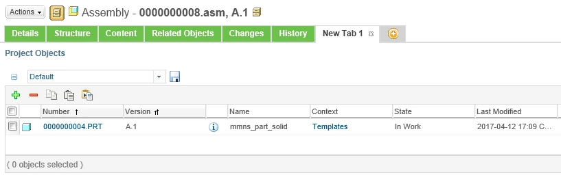

Oct 17, 2017 1:44 PM UTC
There is for sure a possiblity to link to cad models in Windchill. The magic word is called "Configurable link".
You need to add a wt property
<Property name="CONFIGURABLE_LINK_ROLE_CLASSES" overridable="true" targetFile="codebase/wt.properties" value="wt.epm.EPMDocument"/>
To implement those configurable links a small customizing is needed.
Have fun
