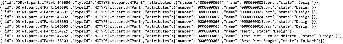

Say you want to get all the parts that starts with number 000000006, you can make a rest api call like below. In the select you can select the attributes of the element which you want to retrieve.
http://ourserver/Windchill/servlet/rest/objects?%24select=name%2Cstate%2Cchild&typeId=wt.part.WTPart&%24filter=startswith(number%2C%20%27000000006%27)
We will get a JSON response like this.
