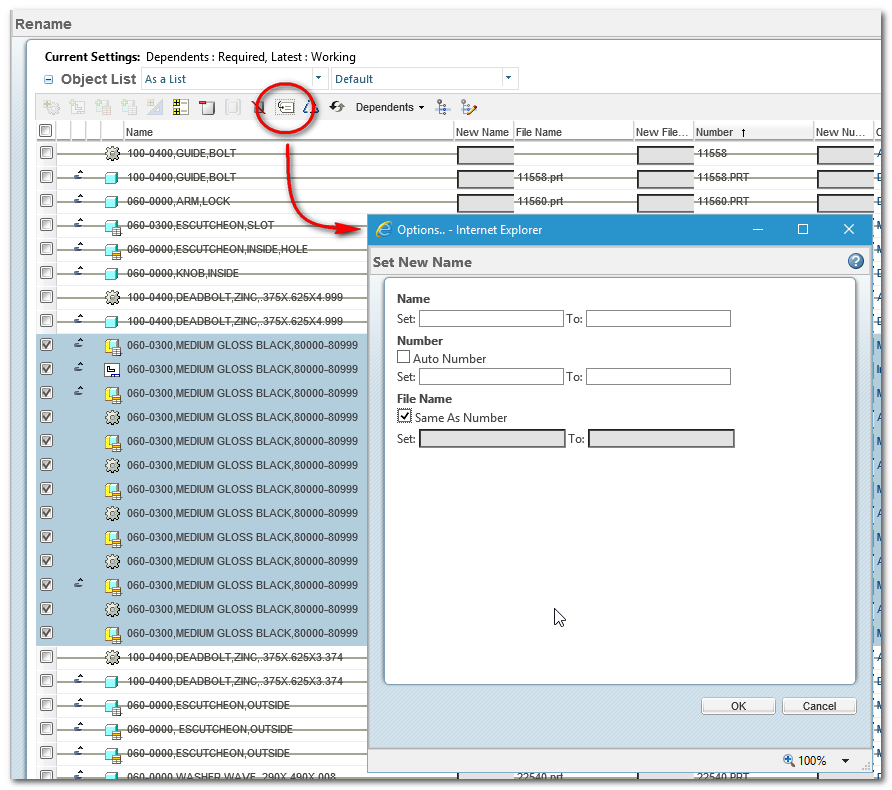

Paul,
Have you tried using the Set New Name option?  (See screenshot.)
