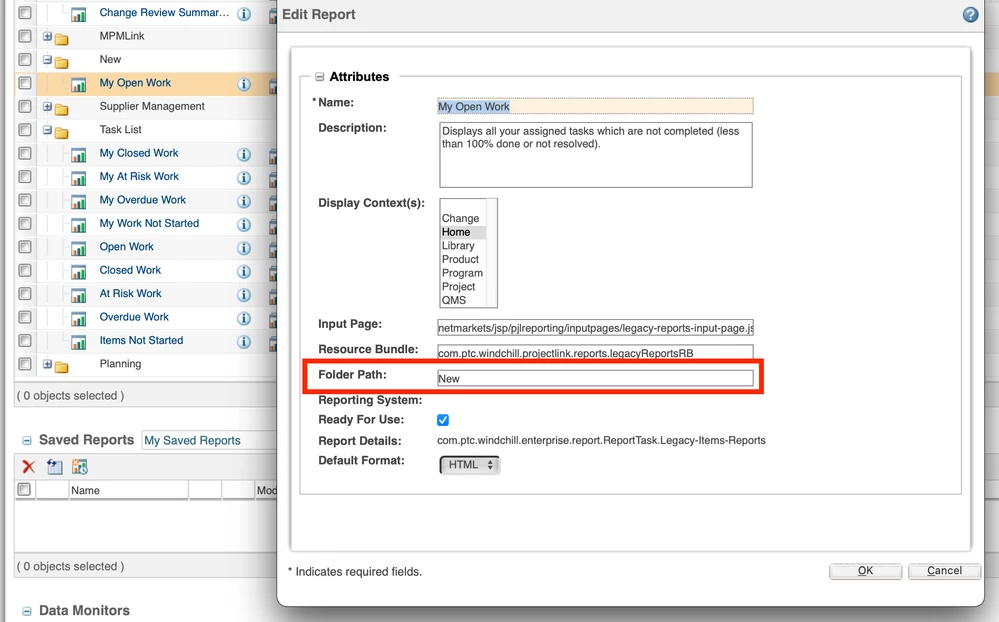

Is there any possibility to create a folder inside "Reports" at Org/Site Level to move reports?
Mar 28, 2022 9:14 AM UTC
Just edit the report and enter a folder path. The "folder" is being created automatically
