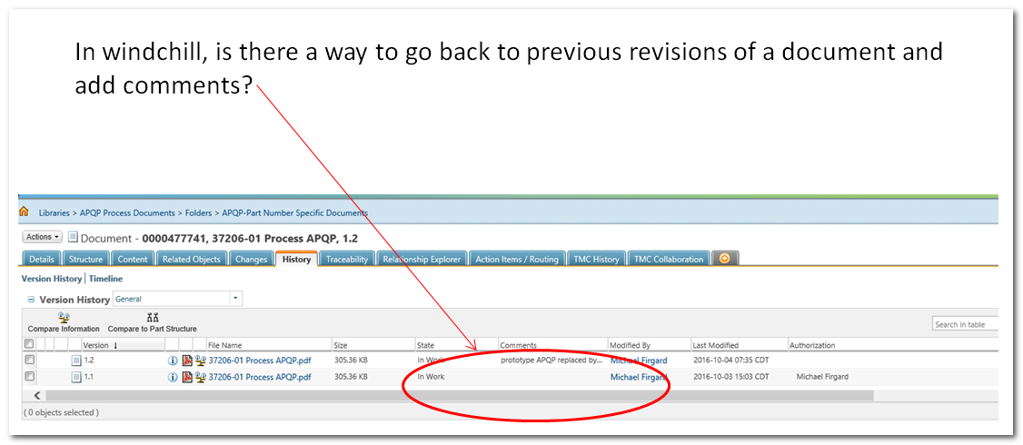

Is there any way to add comments to a previously checked in iteration?
Windchill 10.1 m040

Marc DeBower wrote:
Windchill 10.1 m040
This is stored in the noteiterationinfo field in the wtdocument table. Editing it would work very similar to what is described here:

Thanks Randy.
Crikey!  So there is a way for an admin to do so, but not a "normal" user with the correct permissions.   Oh well.
You really shouldn't have to be a Software Engineer to administer the system.
-marc
Oct 4, 2016 2:31 PM UTC
I would not want all users to have rights to edit that data.
Control rights by ACL to allow admins or others to execute a script that would edit a comment.
