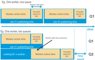

    I would start with multiple workers per host and add additional queue sets.
    (taken from a PPT about 10 years old)
    Multiple Worker per Host Configuration Guidance
    Memory must be able to support all of the worker processes simultaneous and may use the most concurrently when family table based assemblies are checked in
    Typically the family table generic and its instances will align themselves sequentially in the publishing queues and may all come up for publishing simultaneously
    • This condition can be constrained using Queue Sets which we will describe later in this presentation – Disks on the worker are needed to manage the local workspaces for the files that are getting downloaded by the workers
    • You can spread the CAD Worker Setup directories across different disks on the host to span the IO out over multiple disks and avoid any throughput contention that a single disk may have
    • Publish Queue Configurations
    – In a typical installation customers may only have the standard High, Medium and Low publishing queues with no additional queue sets
    – In standard configurations like this, additional PublisherQueue# entries should be created for each additional worker
    • Ideally over configuring the number of PublisherQueue# queues by at least 20 to 40% will help improve throughput as jobs from the H,M,L queues can be placed in the next available PublisherQueue before the next worker becomes available. This results in less idle time on the worker so that it always has work to perform
    • The ratios of queues to workers is somewhat subjective but this should give you a decent setting to start with until you can better calculate your average publishing speeds and throughput
    – A system with 4 workers ideally should have PublisherQueue1 through 6 – A system with 10 workers should at least have PublisherQueue1 through 14 or 15.
    – A system with 20 workers should have at least 25 and upwards of 30 or more
    – A system with 40 workers should have at least 55 queues or more
