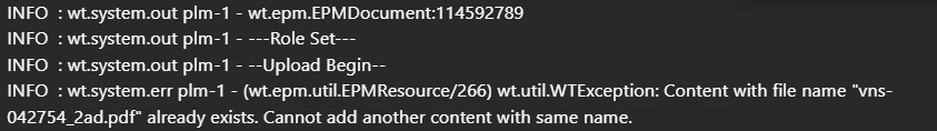

Issue with Eclipse or Code When Changing EPMDocument ID in Java Program
I have a code like this, and I ran it in its current state, and it worked. After that, I changed the ID value in this part ("wt.epm.EPMDocument:114592789") and assigned another EPMDocument ID. Of course, I also changed the file name and file path. When I ran it again, it still tried to send the request using the first information I used. In the console, it gave a warning saying something like "this has already been added" or similar. I tried a few more IDs, but each time it attempted to process using the first information I sent. Is this problem due to Eclipse, or is there an issue in the code? Can you help me?

@ozclkonur , I am not sure the steps you followed. If you have a JAR which you created and loaded into ThingWorx, it was loaded into the Java Virtual Machine (JVM). When you make a change to the JAR file. It may be necessary to stop and restart ThingWorx because the JVM may be holding on to the original version of JAR.
As a test I would stop and restart the ThingWorx Server and see if you get better results.

I've successfully implemented file deletion, but when I check MethodServer, it keeps logging the same message, repeatedly attempting to send the part with the EPMDocument ID 114592789. This was the ID I tried to process when I first ran the application. Since then, I've attempted to attach parts to different EPMDocument IDs like 129025898, but MethodServer keeps making requests for the initial ID. It continuously shows the same log. Is there a way to clear the MethodServer or bypass this issue?

You wrote the ID in the code, that is static. So if you rewrite it, you have to implement new version of the class file on the server.
Usually a restart the method server will reload and use the new class file.
This apply also to thingworx if you rebuild class with new version you have to copy it to the final destination and restart the java procsess
If you want to work with more IDs and you want to define it outside of the code, then you have to use some load from file function where you define your IDs and load it in to a memory your code
