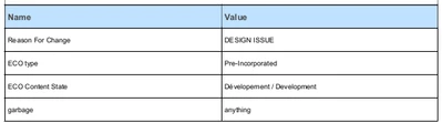

This is the table for soft attributes

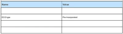

ECN attribute "ECO Type" and its value is "Pre-Incorporated." , other user defined attributes exist in the ECN as well, without editing, all attributes are shown.

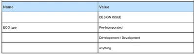

To filter those out, in the OOTB Template use this in the NAME text field: Where "ECO type" is the display name not the internal name of the attribute
$F{NAME}.equals("ECO type") ? $F{NAME} : ""
Use this to filter the VALUE text field:
$F{NAME}.equals("ECO type") ? $F{VALUE} : ""

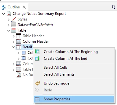

To hide the rows that do not match the criteria because their results will be null (empty), add this to the Detail Properties within the specific Table.
Print When Expression: $F{NAME}.equals("ECO type")
