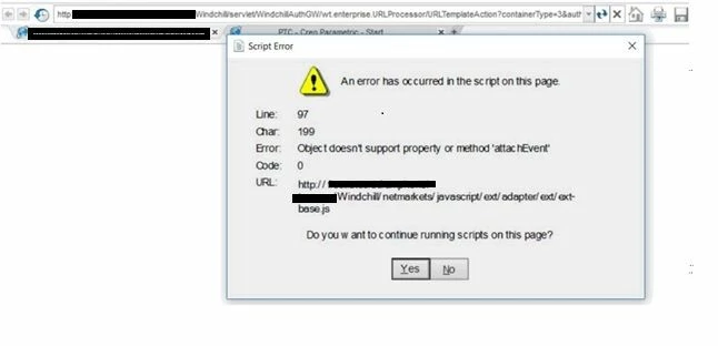

This problem is only when trying to open Creo files from a standalone browser, this case Internet Explorer.  Opening files from the Windchill embedded browser works fine.  After removing the highly customized config.pro from the picture, was able to get a Script Error to come up. Trying to clear these errors with "yes" doesn't seem to work. Creo never launches.browser-javascript-error.jpg
Seems to be generated from this file:
codebase\netmarkets\javascript\ext\adapter\ext\ext-base.js
specifically this line 97 (which is all one line but I can't format that here):
if(Ext.isIE){function a(){var d=Function.prototype;delete d.createSequence;delete d.defer;delete d.createDelegate;deleted.createCallback;deleted.createInterceptor;window.detachEvent("onunload",a)}window.attachEvent("onunload",a)}})();
I am waiting for more info from the customer on some additional testing. I have given them the browser requirements for their installation to ensure they are using something modern/supported.
In the meantime, how do you track down why line 97 is a problem or where else it points to? In other words, how to figure out just what object isn't supporting attachEvent? Is IE that is not supporting this action?
