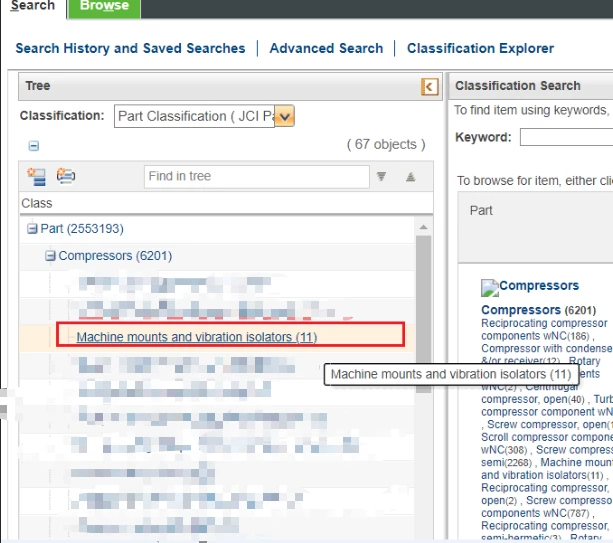

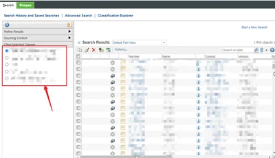

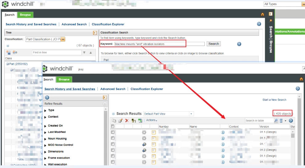

When we search the name: Machine mounts and vibration isolator in the keywords field, we get 435 parts, however, the actual number of data is 13. in 435 parts,  13 parts are not even included.
PTC engineer said that the parser will divide the word into 5 parts:
Machine* or mounts* or && vibration* or isolator*
The “space” will be parsed as “or”, the “and” will be parsed as &&," or" will be parsed as II, it will get many unexpected results.
PTC gave the following workaround, but why can't the search field be searched as a whole phrase to get accurate data?
