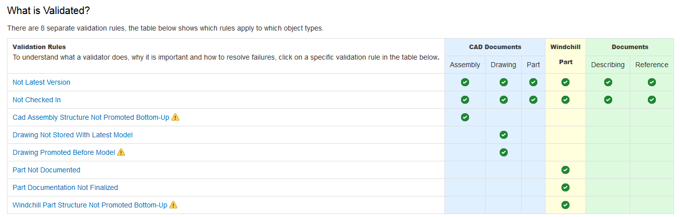

Feb 28, 2017 10:53 AM UTC
Ben
I'm not a developer, but I believe the custom PN wizard validator route was pretty in depth and few weeks of work. In our case this also implements several other customizations so cannot easily be extracted standalone. I'm happy to share the functional spec, if interested? We have 8 validators in total (see below), which are reasonably generic in nature. Frankly speaking, I think PTC should have made half of them out of the box.
I would also like validate that CAD models are not promoted before any dependents, not just assembly dependents. A change of mindset and working practice is required first as bottom up approval is completely at odds with top down CAD model strategies.
Catching issues in the workflow is easier, but you are responding to a problem rather preventing a problem from ever occurring.
