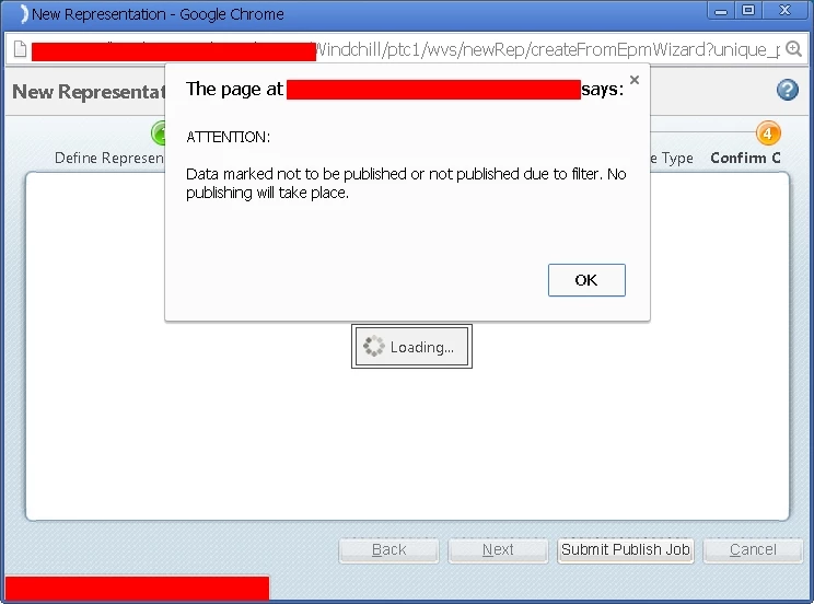

Thanks for the usful tips. How is it possible to stop Publishing of the object only in released state? Please share an example if you have.
regards,
Vaibhav
September 26, 2014
Hi Vaibhav,
You can use either publish rule or create custom class to filter object and add that filter class using “publish.service.filterpublishmethod“ property
Property description
public static Boolean methodname(Persistable p, Boolean publishFromDB)
