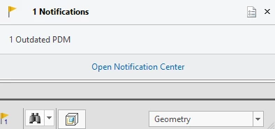

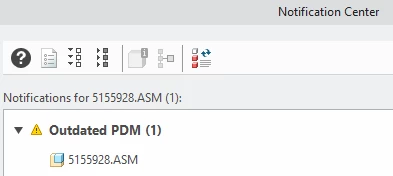

Somehow, I've modified CAD assembly in my workspace and then checked it out, and now Creo Parametric keeps insisting it that it is "out-of-date".

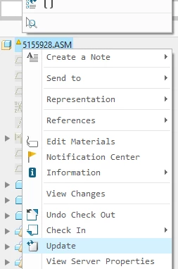

I tried to use "update" function:
system asks for some objects in session to be replaced with ones from the workspace; I agree - afterwards, the annoying message is still there:
I've refreshed the workspace, tried to synchronize (says nothing to synchronize)...
So I don't understand - this is the latest version and it is checked out.  So by definition, how can it be out-of-date?

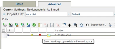

Well, the workspace copy is at the same version and iteration as the server copy; and as it is checked-out, I can't do the add-to-workspace trick:
At this time, I guess it is what it is.  Seems like a bug to me.
