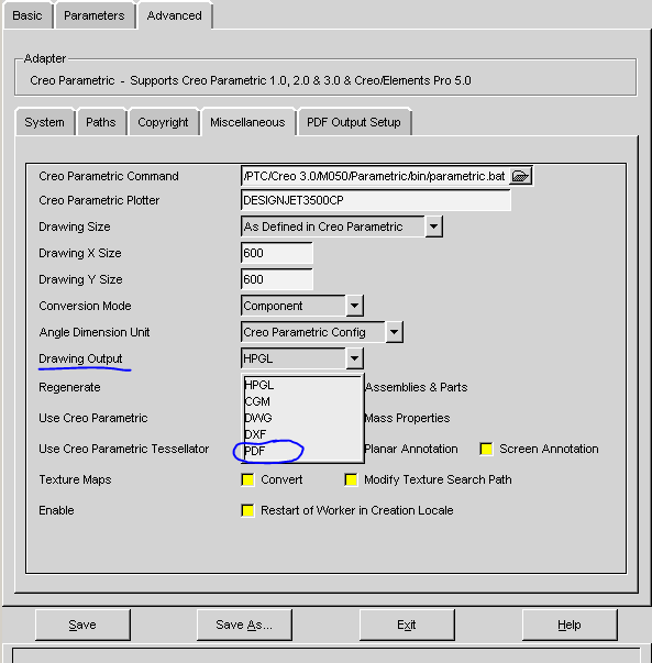

We have configured Windchill to create pdf files from publishing CAD model drawings. The desire is then to select the thumbnail on the cad document details page in Windchill and have Creo View open the created pdf file. However, what we are getting instead is Creo View opening a plt file instead. How do you set the selection of the thumbnail into Creo View as the pdf by default?

TomUAnswer
Sep 30, 2015 6:56 PM UTC
You have to configure the cad worker to use PDF as the output for drawings.  Whatever is selected in this dropdown is what is opened by Creo View.

Oct 1, 2015 12:45 PM UTC
Tom - Thanks for the input. It appears that we missed this setting in a recent modification of the recipe file. I did not see the following:
adapter/outputDXFDrawing=4
Thanks!

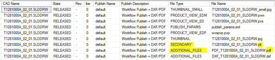

Oct 1, 2015 12:18 PM UTC
Just to elaborate on Steven's point above, when the drawing is published, whatever is selected in drawing output dropdown (shown above) is marked in the database as "SECONDARY".  Any other extra files that are published at the same time are marked as "ADDITIONAL FILES".  The object marked "SECONDARY" is what will get loaded into Creo View.  To change this without republishing would require you to go to the database and swap these two values on all of the affected objects.
I'm sure this is not supported by PTC, so unless you have a great number of these it probably makes more sense to just republish them.
