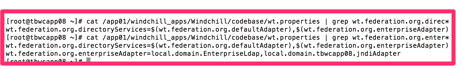

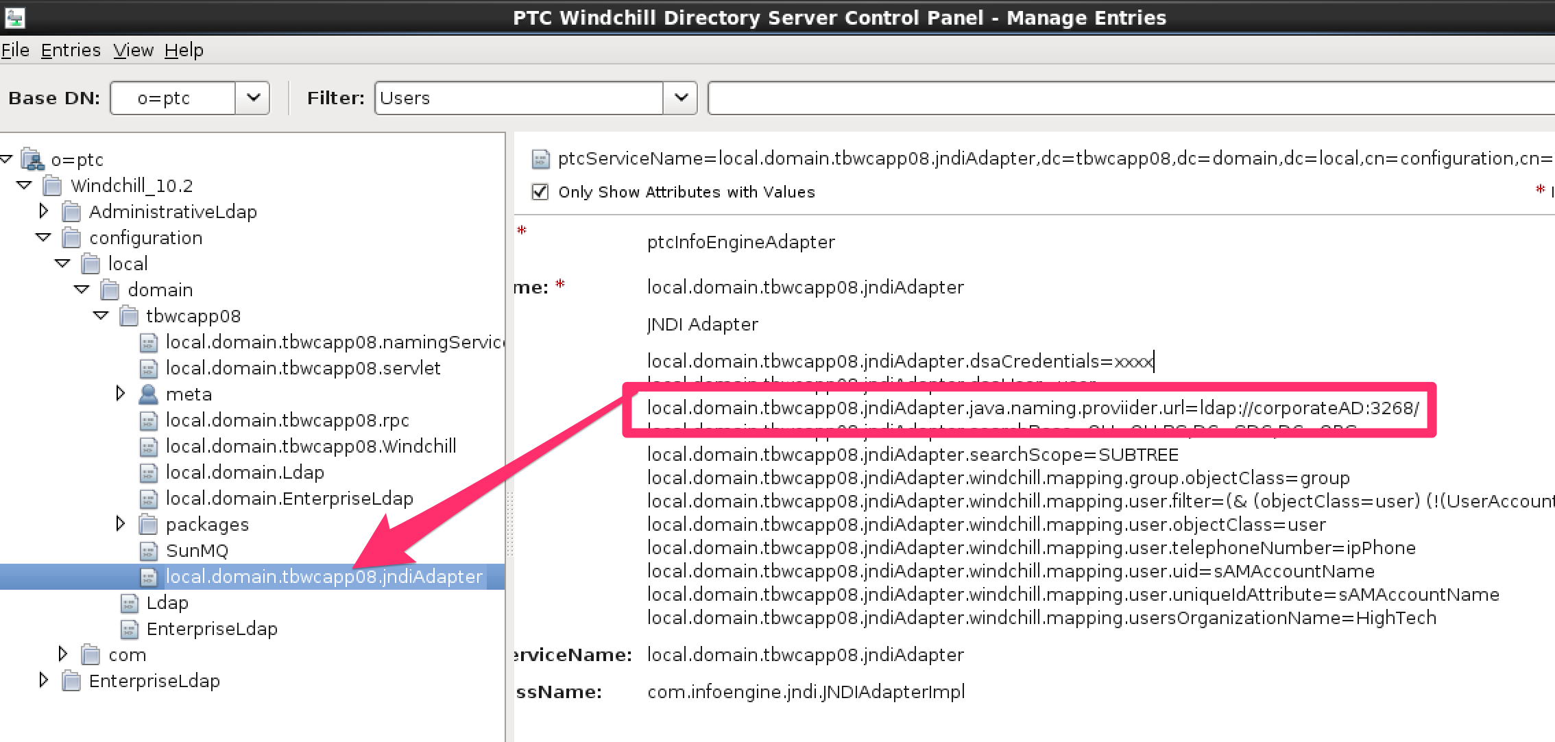

Do you know the JNDI adapter corresponding to the LDAP which is down? You can remove the adapter from wt.federation.org.directoryservices property from wt.properties and bring up the Windchill system.
You can get this information from the WindchillDS
Remove the jndi adapter which has unreachable domain controller from wt.properties and restart Windchill

I just got off a session with PCT and that is exactly what I had to do.
We found the adapter in windchillDS then removed that adapter from the wt.properties and propagated it through windchill shell then started the services.
That did the trick.
