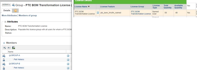

Hi @amar_karthi
It should be shown as one license is consumed even the user is assigned in multiple groups and the groups are assigned to one license group.
Just try it and you will see.
PetrH
