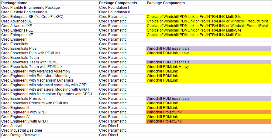

Some of our Pro/Engineer/Wildfire/Creo Parametric licenses came bundled with a heavy user license of Windchill PDMLink when they were purchased. I'm trying to sort through all of this.
Does anyone have a link to a PTC document that shows this information? Including for older licenses of Pro/E?
Or is it the usual PTC M.O. of making this as arcane as possible. I mean, the amount of confusion and time spent trying to sort though this at 5 different companies was quite frustrating.

This is from an old Excel file I have:

From my experience, license bundling was/is too dynamic to rely on anything published.
What I recommend you do is get your license summary (used to be called a customer detailed report) for each company. These are excel spreadsheets which you can then review. Biggest problem with this is that this is what PTC thinks you own, it might be wrong.

Start here:  https://support.ptc.com/appserver/lm/bswt/bswt_connect_v.jsp
The detailed license report (Excel) is available here:  https://support.ptc.com/cgi/cs/apps/lmr/lmr.pl

Nov 6, 2015 5:00 PM UTC
