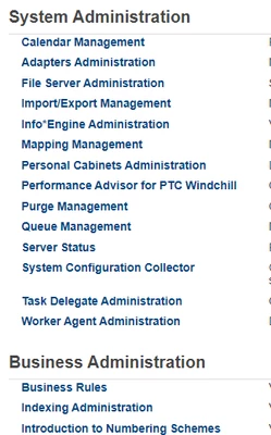

License management utility is not seen though I am the site administrator.
the License management utility and also Windchill Diagnostic Tasks Scheduler is not seen though I am the admin for site. can you please guide me if I have to add any profile. but I see it in 12.0 version which i have installed it on spare machine.

What version are you not seeing it in?

Oct 18, 2022 3:21 PM UTC
Release: 11.0 M030-CPS22
Oct 18, 2022 3:42 PM UTC
11.0 does not have License Management. That is new in 11.1.

Make sure the site admin is not a member of any license profiles.
https://www.ptc.com/en/support/article/cs329469
