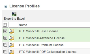

Apr 24, 2023 2:46 PM UTC
In case you ever need it, you can export license profiles to Excel and compare all the differences in detail. I think this is available starting Windchill 12 or so.
Site > Profiles
HelesicPetr
Apr 25, 2023 6:36 AM UTC
Hi @joe_morton
Your suggestion is the best way how to check the license functionality and how to compare it.
I use it a lot.
The XLS example attached.
