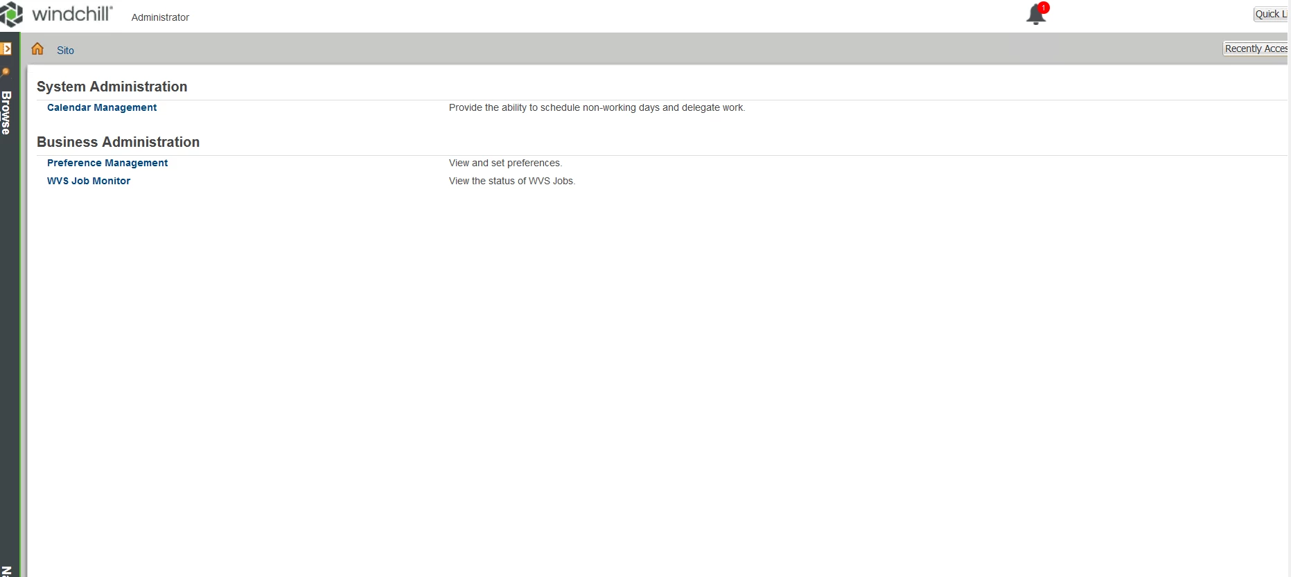

Licensig file retrieved but windchill not working
I am using Windchill PDMLink Release 11.2 and Datecode with CPS 11.2.1.2
Retrieved licensing file, but always menu obscured

    Jan 27, 2025 8:24 AM UTC
    License file and screen in attached
    HelesicPetr
    Jan 27, 2025 9:31 AM UTC
    Hi @FC_9723361
    You have to remove the admin user from any group or profile.
    Then you will see all the site options.
    Usually it is cased by old license groups that are not used anymore.
