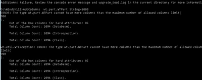

for global IBAs there is no limit, for local (standard) attributes there is a limit :
Buiꓘa
