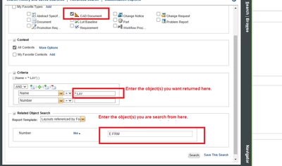

In the example below I'm doing essentially the same thing you're looking for.
I want to find all Creo Layouts used by a particular Creo Format.
The Format is to your Drawing as the Layouts are to the drawing's models.
The trick is knowing Query Builder and Related Objects Search.
So, I create my query report.  No big deal there.
Then I go to Advanced search.
Here's the part that you need to pay attention to.
In the criteria field enter the object(s) you are trying to find.  I wanted only Layouts, so I went with *.LAY.
Then in the related object search I entered the number of the Format I was curious about.

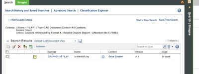

Seach returns that E.FRM is used by only one layout.

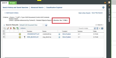

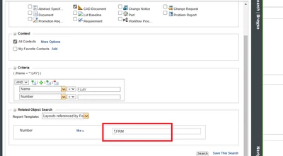

If I want to see all Layouts referenced by all formats I simple wildcard my format input to be *.FRM rather than E.FRM
Search returns all layouts used by all formats.
In your case, you'd enter *.* to return all drawing models
and in the Related Object Search fields you should include the drawing's number, revision and the iteration.
My example has only number available to enter, it's just a demo, but you'd really want Number, Revision and Iteration.
Hint: use like in your query builder to be able to wildcard inputs.
