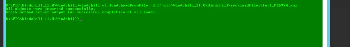

I am so far that I know I have to define a XML file with the informations for all Documents and load it by Windchill Shell in this style (concret example):
<?xml version="1.0"?>
<!DOCTYPE NmLoader SYSTEM "standardX20.dtd">
<NmLoader>
<csvPartDocDescribes handler="wt.part.LoadPart.createPartDoc
Describes">
<csvdocNumber>0000001598</csvdocNumber>
<csvdocVersion>A</csvdocVersion>
<csvpartNumber>ME6994</csvpartNumber>
</csvPartDocDescribes>
</NmLoader>
Since you offered it, can you help me with the XML file? At the moment I am not familiar with the creation process. In the meantime I test it as you can see in the attachment, but I don't the result in the Windchill system. What's wrong? It seems that the xml is not right, the soure is in the .zip and was converted succesful?!

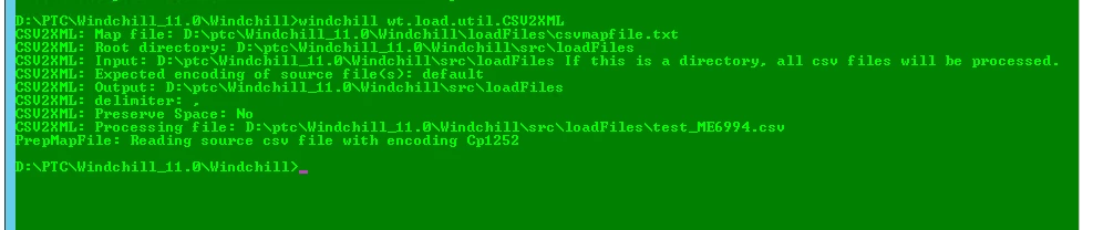

22-Sapphire I
Dec 9, 2020 9:36 PM UTC
Example attached.
A bit more to this to start with Excel, convert to xml.
