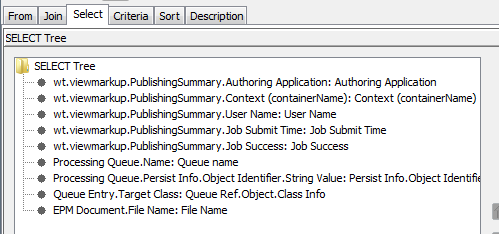

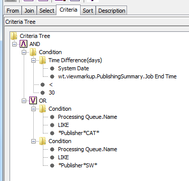

trying to write query builder report to report on status of publishing queues. So far managed to get basic queue summary info, and link back to get the actual source queue name, but struggling to get back to the source EPMdoc info.
So far pulling from here:
and selected the following:
with following criteria:
but as soon as I add the select from EPMDoc the report fails.
Obviously missing something important between the queue and the EPMDoc, but what? Any idea?
