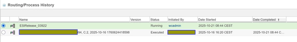

I below a part of the process tab of a promotion request. As you can see the process is still running.

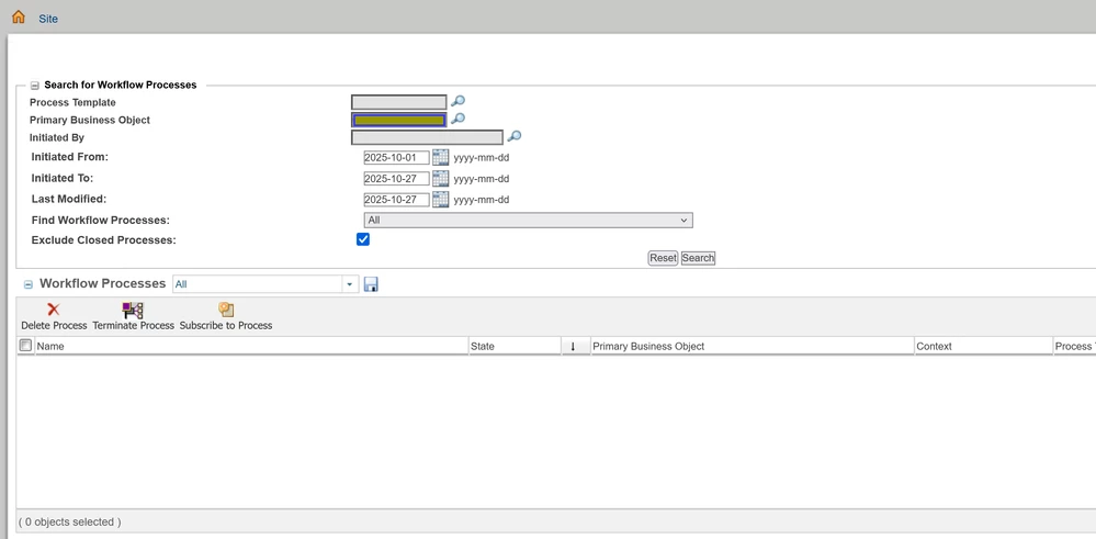

But when i lookup the same process is don't result in any processes.

Try removing the "Last Modified" date? Is it possible the workflow wasn't modified today, and so it's getting excluded?
jw_CS14-AlexandriteAuthor
Oct 28, 2025 9:46 AM UTC
Oke this give in this case the expected result

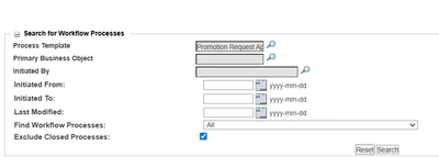

Do you know if it is possible to search within Primairy Business Object ALL promotion requests and a single one?
If i choose Process template it shows also the objects inside the promotion process (WtPart, CAD models etc).

Get all the open promotion process using the following filters.

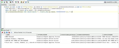

you can further develope bzlow query ;
select pn.name, m.name as WfTemplateName, pn.ida2a2 as PromotionRequestIDa2a2, p.businessobjreference, p.name as WfProcessName
from wfprocess p, wfprocesstemplate wft, wfprocesstemplatemaster m, promotionnotice pn
where wft.ida2a2 = p.ida3a5 and m.ida2a2 = wft.ida3masterreference
and p.businessobjreference like concat(concat('%', trim(to_char(pn.ida2a2,'9999999999999'))),'%');
