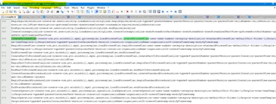

we have below file with csv pattern
the conversion to xml is done by csv2xml tool https://www.ptc.com/en/support/article/CS358782
