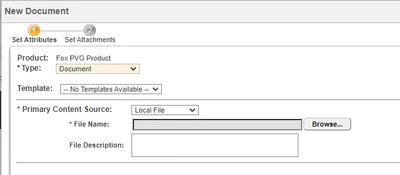

Loading EPM documents (DITA) into Windchill
Looking for a way to upload and download DITA files into Windchill that does not require Arbortext.

Jul 27, 2024 5:01 PM UTC
I still don't have an answer on how to load a dynamic document (DITA XML) without using Arbortext.

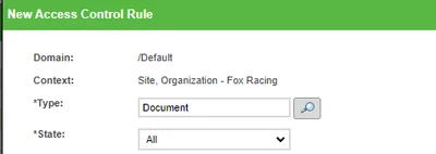

Isn't there an ACL that would allow me to load a file in a specific library?  We are trying to load an XML document into a database...
Jul 29, 2024 11:52 AM UTC

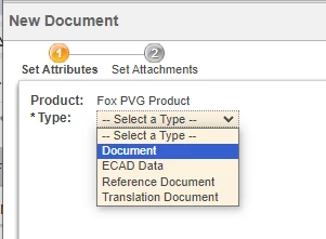

You would set up an ACL for a "Document".  Then you would upload your XML as a document.  You can either browse for it or you can drag and drop it in.  If this isn't what you are looking for, then you need to describe what you are looking for better.
Setup Document ACL:

Choose type of Document:
Browse for or drag and drop document:
