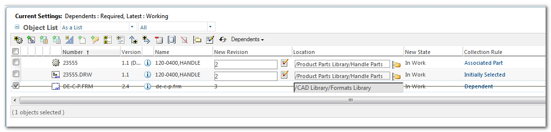

When I revise a drawing and parts the drawing format always comes with the files and I have to "Remove selected objects" of the format so I don't accidentally up-rev it.  Is there a way to lock this format down to where it is grayed out when doing something like this?  The format is released and in a different formats folder.
I also have the same issue when I move files around.  If I want to move a drawing from one folder to another and I select the drawing the drawing format get collected with it.  I have to "Remove selected objects" of the format to make sure I don't move that as well.

We have our permissions configured such that once on object has been released, normal users are no longer allowed to move it or change it's state.  Of course this doesn't help if you're the administrator.  It would be nice if all the things the user doesn't have permission to change automatically had the grey line drawn through them.

We do too, but the format still shows up in the list of objects and has to be either removed, or excluded.

You've tried Policy Administration?
Place your .FRM files into a library specifically used for stuff like that (formats, start parts, etc.)
Use the Policy Administrator to remove the ability of the admin to move files found in that library. Now, when you move your .DRW & .PRT/.ASM. Test if the move collector even picks up the format.
I didn't test so I can't be sure it won't collect the .FRM even with the permissions changed. I have a feeling it will still collect, but at least will stop the move from happening if you forget to exclude it from the list.

We have format in a library and a part of a very limited number of people . users can only read/download the released format.
As a consequence, when they revise a drawing, while the collector shows the format, it is automatically crossed. No risk for the users to revise a format by accident.
Also, as Don mentioned about Move.  Only Admin could move files from folders to folders or context to context (we do not have same OIR for all contexts).
So Ryan, talk with your admin , he should change the configuration to prevent such situation.  Nothing to do with Windchill

Keep all formats, template in a folder tremed "common".
Create a new domain policy called "common" In access control create
1. WTObject; All state; Product Manager; Full Control
2. WTObject; All state; Product Manager; All Expect ; Read & Download ; (Deny to all other permission)
Using folder domain; apply /Default/Common
Now users will be able to use the format; but no modification
