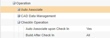

The Mech Engineer has been creating the 'gear' part manually. I think this should be automatic when the CAD is checked in, as part of 'bottom-up' design: the 'gear' should appear. Yes, I know there is a default to make this automatic, but for me it does not make any difference whether I have to click the check box: the 'gear' does not get created when the CAD is checked in. And we get the above error which does not tell me what I need to know.
Maybe this detail is related: the top-level 'site' Organization has no CAGE code, and I think this CAGE would be the default for new CADs and 'gear' parts. Does it make any sense to have the 'site' Organization without a CAGE code?

It can be created automatically. You need to set this preference at site level:
Just know that when you allow this, all garbage models will have gear parts created. Queue Facts of Life song.
