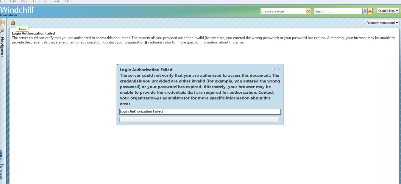

I'm trying to change the URL of my Windchill by doing reverse proxy of Apache. I'm reffering WCAdv Deployment guide and also
this thread http://communities.ptc.com/thread/34430.
I have completed all the steps and after restarted all the services.Then when I try to access windchill
with my new URL it is showing Login Authorization failed error.But it didn't asked for username,password.
Am I missing something?I have attached the image for my error.I need your help and suggestions.

Did you restart your browser after setting up the reverse proxy? The error that Vino shows above looks like the user was already logged into Windchill when apache's configuration was changed. Try restarting your browser and see if you can log in. If you can't authenticate after restarting your browser, then that means there's a problem with Apache's authentication configuration.
Aug 25, 2015 5:57 AM UTC
Thank you for your reply.
I copied Apache folders from Windchill server to Proxy Server then edited httpd.conf file. I think that was why I was getting the error. It is better to install a new apache instead of copying one to another location.
I understand copying apache is not enough for a stable solution. When copied there are lots of config that should be considered. Then I seek for Apache installation file on web and found Apache Version 2.2.25 download link from apache.org domain.
Reverse Proxy on Windchill is working stable now after installing the one I downloaded. Of course I did all the configs written in the solution I referred.
